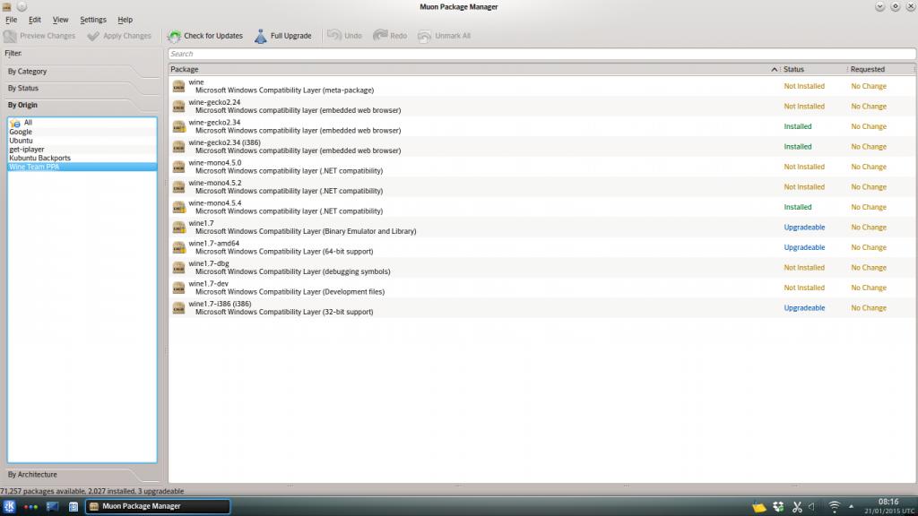

    I'm happy with the current version and would prefer not to upgrade it.
    I locked the packages. But is that sufficient?Click image for larger version

    it should be ,,that is how it is supposed to work .
    the next time you do updates , do it in the terminal and you will see what is going to be upgraded and can abort if you see wine(your locked packages ,,you still have 2 unlocked) is in the list .
      2 packages will not lock, I think it's because they are the same package as the _64 counterpart. I use a _64 system

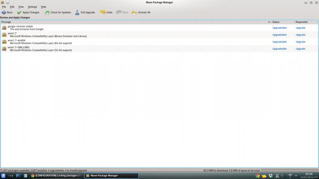

      Using 'Full Upgrade' I get this, which I assume is going to update the locked packaages
      Yes, I figured....
