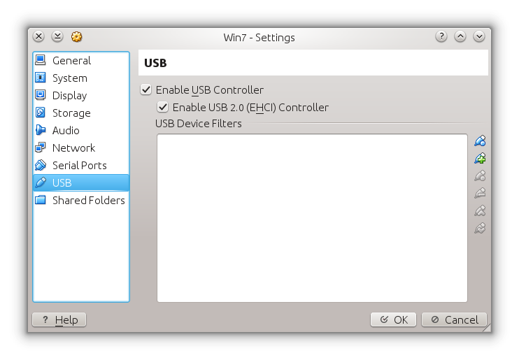

          And you have enabled usb in the settings correct
          Also, Make sure your user is part of the vboxusers group. If you do not know what that is then do some googling.
