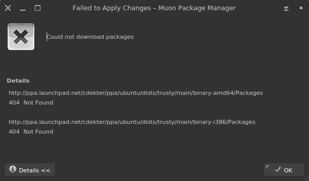

                  however, this is what happened (presumably Muon's way of describing the same thing that was happening with apt-get earlier):

                    Those are PPA repositories, and there is no guarantee that a selected download server will know about them.
                      PPAs do not have mirrors like the normal Ubuntu repos.
                      This last error could also likely be that you have a ppa that does not have a Trusty (14.04) component .
                      And my thought is correct:
                      Reading package lists... Done
                      W: Failed to fetch [URL]http://nz.archive.ubuntu.com/ubuntu/dists/trusty/InRelease[/URL]
                      W: Failed to fetch [URL]http://nz.archive.ubuntu.com/ubuntu/dists/trusty-updates/InRelease[/URL]
                      W: Failed to fetch [URL]http://nz.archive.ubuntu.com/ubuntu/dists/trusty-backports/InRelease[/URL]
                      [COLOR=#ff0000][B]W: Failed to fetch [URL]http://ppa.launchpad.net/cdekter/ppa/ubuntu/dists/trusty/main/binary-amd64/Packages[/URL]  404  Not Found
                      W: Failed to fetch [URL]http://ppa.launchpad.net/cdekter/ppa/ubuntu/dists/trusty/main/binary-i386/Packages[/URL]  404  Not Found[/B][/COLOR]
                      Going to the ppa's page, it most definitely does not have packages for anything newer than Precise 12.04, so you can remove it.
                      This is one reason why the official upgrader disables PPA entries before proceeding with its job.
