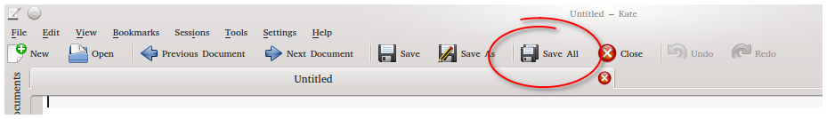

    I recently installed Kubuntu 14.04.1 64Bit onto my slow thin client.
    The OS installed properly and it is fully updated.
    I have a problem with KATE text editor.
    I am trying to add [Save All] to the toolbar on top but it does not work:
    (see screenshot below)
    Is this a know issue with KATE on 14.04.1 ?
    I am a video game programmer and really need [Save All] to work now.
    Any help would be appreciated!
    Jesse
    Works for me.

    Check Kate's Settings > Configure Kate... > Plugins to see if you have Tab Bar checked. Just a thought.
      Works for me.
      [ATTACH=CONFIG]5232[/ATTACH]
      I tried your suggestion but no change.
