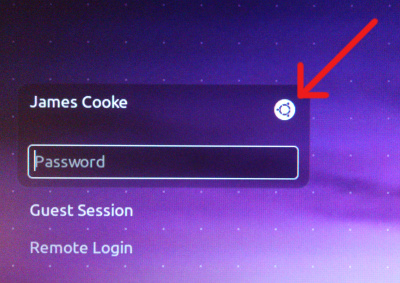

    On the default Ubuntu login, it will look something like this (I think).
    Note the arrow. Click the Ubuntu icon there, and you should see a drop down to select either Ubuntu/Unity, or Plasma Desktop. Select that. It will now be the default until you decide to log in to Unity again.

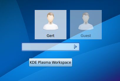

    If you are using the Kubuntu login screen looks something like this (I think):
    Note the box below the user list. It should be a drop down list where you can choose which desktop to log in to.
