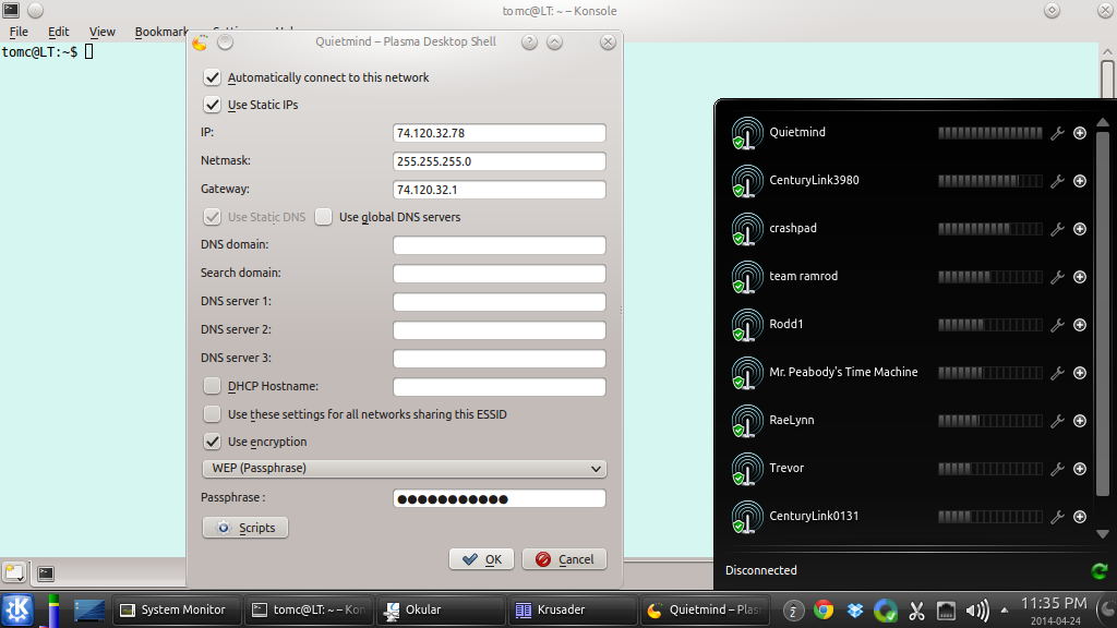

    The problem, as has been pointed out elsewhere, is that the driver for my chipset is not available through this method.
    But beyond that, you say "you should see your routers wifi ID listed" - and I do - then "enter the WPA password and you are done". It isn't asked for. Clicking the wrench I get the "Connection editor" modal window. What's supposed to happen next isn't exactly obvious. Clicking "help > connection editor handbook" yields a page titled "documentation not found".
    Clicking "About" on the same dropdown, I see that I'm running Connection Editor 0.9.3.3. I go to the KDE website. It doesn't even have a search function. After browsing for a while, I give up. No mention there of "Connection Editor". Apparently only The Chosen are given the Secret Knowledge.

                        UPDATE: I downloaded WICD and removed NewworkManager, carefully following the procedure outlined here. WICD allows a somewhat different set of security options, such that I had to change security from WPA-PSK [TKIP] + WPA2-PSK [AES] to WEP.
                        I can definitely connect using an ethernet cord. When I try to connect wirelessly, though, I just keep getting "bad password" messages. But the password is NOT bad. I was getting this same message before I changed the security protocol. I discovered the protocol problem when looking for why I might be getting the message. It appears that I have not found the reason.
                        Here's a shot of my screen. My router is Quietmind, and the WICD edit box is also displayed. I hope someone can suggest what I'm doing wrong.
                          #27
                          I don't think WICD, which I used to use, is keeping up with the changes. The "bad password" message is a common problem when parts of NetworkManager are not removed.
                          Your best course of action is to PURGE WICD and re-install NetworkManager.
                          What appears to be happening is that your connection is repeatedly connecting and disconnecting without every allowing you to log in. If that is the case then you should see "authenticaing ..." followed a couple lines later by "deauthenticating ..." in the SystemLogs.
                          deauthenticating from by local choice (reason=3)
                          There are several possible causes for this:
                          One is that the wireless router may be set for N band only but the wireless chip in your laptop cannot do N band connections, only a or b& g. Check your wireless router and set it to the b&g band to see if that allows it to connect. I installed Kubuntu 14.04 on a 10 year old gateway with a BCM4306 wireless chip and ran into that problem. Also, when my son came over he found that his iPad could not connect to my N band setting. So, last night, I switched it to "NG Mixed", which allows either an N or G connection. (N connections on my wireless router can reach 300Mb/s, but G's maximum is 54Mb/s.)
                          Another is that your router security setting is wrong. TKIP settings do not connect well. You may have to log into your router and change from TKIP to WPA2-PSK [AES]
                          Another is the nohwcrypt=0 setting, a parameter of some wireless drivers. It should be set to nohwcrypt=1. However, since your wireless is a BCM4306 (IIRC), this option isn't your problem because the b43legacy driver does not have a nohwcrypt parameter.
                          And yet another, which is a problem which plagued me in 12.04, is that when the kernel upgraded the new ath9k driver could not drive my Atheros 9642 chip properly. Switching to a 3.9 and later 3.11 kernel solved it. In some cases downgrading the kernel, especially for older machines, may be the solution.
                          Anyway, to help you with your problem Ubuntu (Kubuntu) has a set of commands that gives information that can be used to resolve your problem.
                          https://help.ubuntu.com/community/Wi...otingProcedure
