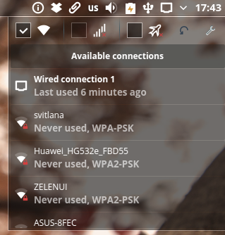

          It's funny thing but after I restarted my laptop it suddenly all worked:
          But then after a few minutes the list disappeared again.
          I literally don't understand what is wrong.
            I think I know what the problem is. I checked a few times, only after I launch ap-hotspot app, the list disappears, seems like it blocks wifi somehow.
            Oh, well, but thanks everyone who tried to help me
