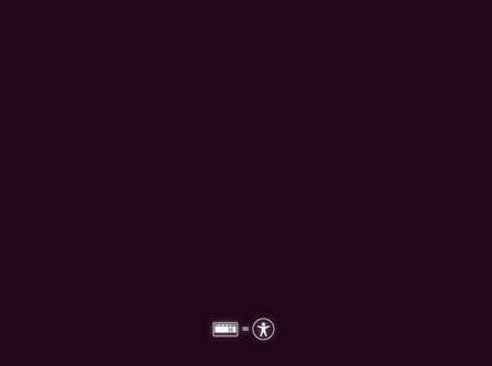

    When the livecd/drive first loads, there should be a small keyboard-looking logo at the bottom.
    Hit any key, and you will see various boot options. iirc f4 will bring up different modes, and you will want to try 'vesa' if it is available.
    It does look from a cursory search that your card may not easily work with modern distros as the the mach64 driver the card uses does not see much love these days.
    Of course, the other option is to install the sever version of Ubuntu (text mode install) and then try and see if xorg will work once it that is installed.
