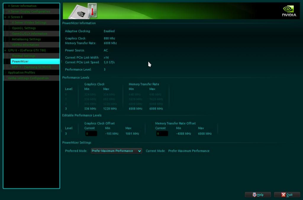

    Problem - I have installed the 343.22 Nvidia Driver ( I had same issues with drivers shipped standard with 14.04 LTS ) and I am unable to do the following things.
    1. Start in Max Performance level 3, even though I added the option Option "RegistryDwords" "PerfLevelSrc=0x3322; PowerMizerDefaultAC=0x1" in my xorg.conf. The card starts @ 692MHz which looks like level 1 to me, I have to set it to max on every reboot. This is already set to "max" but upon reboot, it states 692, even though level 3 is highlighted.
    Powermizer settings Click image for larger version

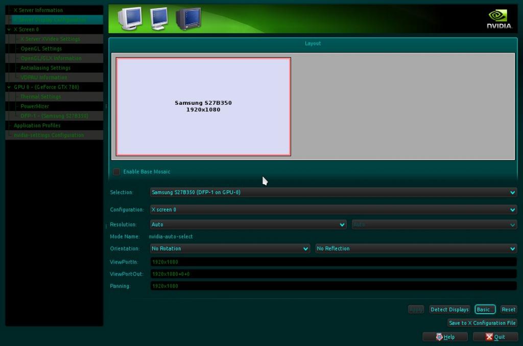

    My nvidia-settings lists my monitor as DPF-1 Click image for larger version
    My xorg.conf. I am running 1 monitor. Any help is appreciated.

    you need to configure things in gui.
    2. save those settings to a nvidia-config-rc or whatever the default name for the file is
    3. add this to a startup script or your choice: nvidia-settings --load-config-only
    the reason being that those settings are per user not system wide.
    also, if it was me i'd start with nvidia-default drivers first
    K 14.4 64 AMD 955be3200MHz 8GB 1866Mhz 6TB Plex/samba.etc.+ Macbook Air 13".
      Don't use glxgears as a performance check. gtkperf is a better comparison tool. I have a eVGA GTX 780 and I get gtkperf 4.5 with Prefer Maximum set and around 6. I leave it on auto most of the time anyway.
      Try this: nvidia-settings -a [gpu:0]/GPUPowerMizerMode=1 > /dev/null
      Put that command in your .bashrc or in one of the X11 configs. Works here.
