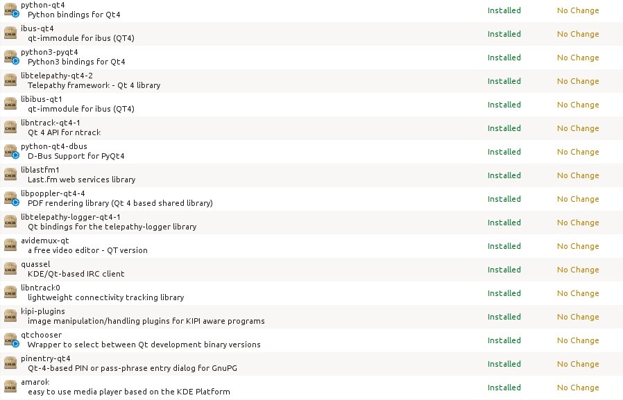

                  I also added an sudo and this did not change the output. When I used Muon to list qt entries, I got a stack of installed packages. I have attached an example of the listing from using qt4

                      Don't do that -- qdbus needs to run in the context of the logged in user so that it can shut down KDE cleanly.
                      qdbus: could not find a Qt installation of ''
                      This is weird -- and I'm seeing a number odd bugs reporting similar behavior. On your machine, what's the output of

                        Thanks for the extra information on what to do. I only added sudo because nothing happened without it. Now for the output you were wanting. Here it is:
                        :~$ ll /usr/bin/qdbus
                        lrwxrwxrwx 1 root root 9 Nov 17 21:06 /usr/bin/qdbus -> qtchooser*
                        :~$ qtchooser -list-versions
                        :~$ ll /usr/share/qtchooser
                        ls: cannot access /usr/share/qtchooser: No such file or directory
                        :~$ dpkg -l | grep qdbus
                        ii  qdbus                                 4:4.8.4+dfsg-0ubuntu22               amd64        Qt 4 D-Bus tool
                        I hope this gives you some insight into what is happening. I did try the command qdbus org.kde.ksmserver /KSMServer logout 0 2 2 on my 13.10 system and it gave the same output as the 14.04 system.
                        I am not sure if this helps you. But I did these commands on my Kubuntu 13.04 system and it gave esentially the same output, ie:

                          Hm... a couple more items, please...
                          dpkg -l | grep qtchooser
                          dpkg -l | grep qt.-default
                          sudo updatedb && locate qtchooser
                          Something is missing or incorrectly packaged on your system. Or maybe I'm not interpreting forthcoming changes from Qt4 to Qt5 correctly. But your qdbus command is failing because QtChooser, while shown as installed in the screenshot you posted earlier, appears to be misconfigured.

                              After looking at the results from my 13.10 system, I decided to check on the Qt5 packages and installed Qt5-default. This resulted in over 20 other packages being installed. So I repeated the commands that you suggested and now I get an output similar to my 13.10 system. The output is now
                              :~$ dpkg -l | grep qtchooser
                              ii  qtchooser                             26-3ubuntu2                          amd64        Wrapper to select between Qt development binary versions
                              :~$ dpkg -l | grep qt.-default
                              ii  qt5-default:amd64                     5.0.2+dfsg1-7ubuntu13                amd64        Qt 5 development defaults package

                              After adding the Qt5-default and getting these results, I decided to remove the S99.shutdown file which was linked to rc.local. I just deleted S99.shutdown. I am not sure that this was the corrrect procedure for removing this link. Anyhow, my system then returned to the intermitted shut down, ie 5 attempts and the power switch used for 4.
                              I then reinstated the link and to my surprise the file S99.shutdown contained the shutdown text that I had entered previously. This makes me suspect that deleting the file may have caused an error in shutdown. My system is now reliably shutting down with the S99.shutdown file present.
