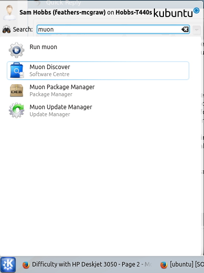

                          Let's try changing where you download your packages from to see if that fixes the problem...
                          Open the search bar and search muon, and select Muon Discover:

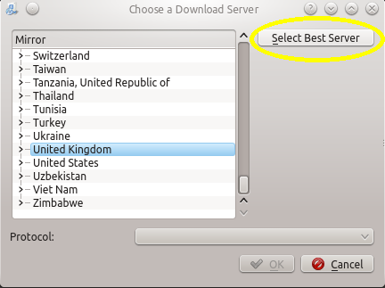

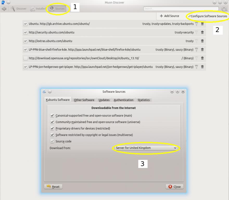

                          Click "Sources", and then "Configure software sources", and then use the drop down and choose "other"
                          Then click the "Select Best Server" and see if your server changes. If it doesn't change then manually choose one somewhere near you (the ones further away are often slower, but all of them should work fine).
                          Then run sudo apt-get update and sudo apt-get install xsane again, see if that fixed your problem.
