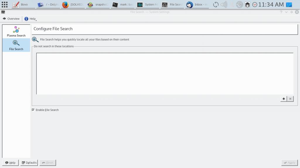

            Thanks for the ideas. It actually led me to the solution. Turns out that it was in system settings, but in a module new to Kubuntu 15. It was actually telling Dolphin not to search that drive! system settings Click image for larger version
            Go figure.
            Thanks.
