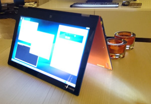

      That's a very nice laptop you have there! Care to take a photo of it with Kubuntu running? I wanted a photo of a nice laptop running Kubuntu a while ago and couldn't find one on Google images.

          Sorry for the photo, not the best :-/
