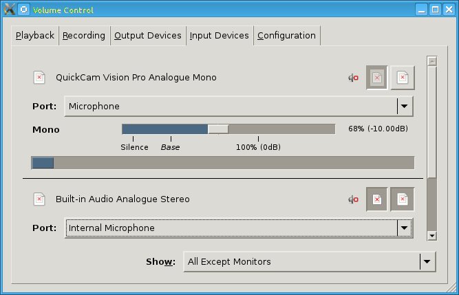

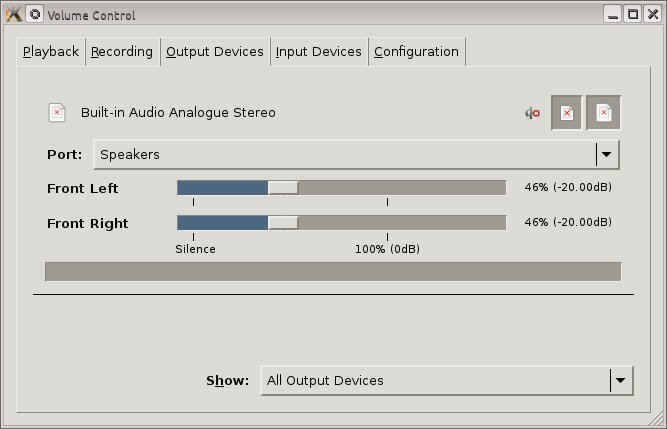

                I installed pavucontrol and I have attached the screens for input and output with Skype running on my system. I also make sure that Systems Settings > Multimedia > Audio and Video Settings have the Audio Recording with the Web Cam at the top of the list.
                  Interesting. I really don't understand why it isn't working; the pulse server just doesn't see skype at all.

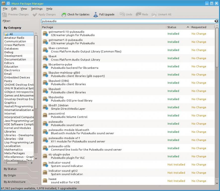

                      I did make the change to default.pa that you tried and Skye still worked well on the Echo / Sound Test Service. Also, all my other sound files and movie files still work as before. For what it is worth, I have attached an image of muon with all the pulseaudio packages that are on my system.
