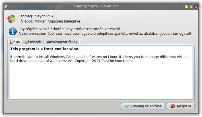

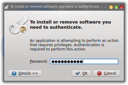

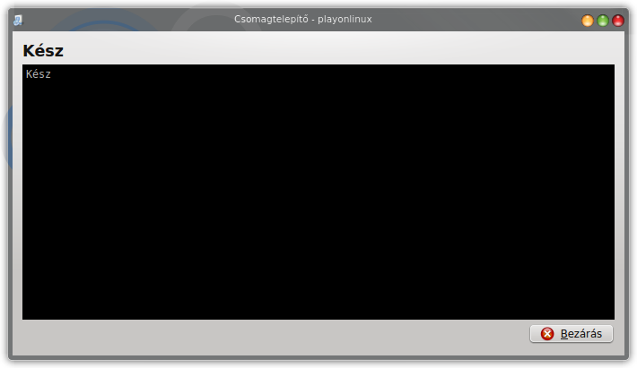

      For example, I'd like to install Playonlinux.
      1. I download it from the official site.
      2. Then I navigate to it in dolphin.
      3. Make it executable as a program. (By the way if I don't make it executable, it won't be installed either.)
      4. Run it.
      5. The following steps are the pictures below: ("Kész"=Done)

        You don't need gksudo to run a gtk app. gksudo is a gtk app. kdesudo will run a gtk application just fine. gksudo isn't installed by default in none gtk-based distros like Kubuntu. Neither is USC. You aren't going to find many well-working gtk programs here or much help with them.
        A .deb package need not be made executable to be install. It is in fact not executable and flagging it that way won't make it so. Playonlinux is in the repos, why not install from there? It is one version behind right now, but works OK here. If you're not finding it in Muon, close Muon, open a terminal and type
        sudo update-apt-xapian-index -f
        This should clear the index and allow Muon to display everything again. BTW: Playonlinux is in the Multiverse repo so you have to enable "Restricted Extras" in software sources for it to be in the list.
          Rebuilding xapian index did not have any effect.
          But the latest the playonlinux package is, the better the experience of running windows programs is. For example, when I used to play with League of Legends, I used the oldes playonlinux package, but the game didn't even start. I asked for help, and I was answered, that I should update it from the official website, I did it, and heyy, it worked really good!
