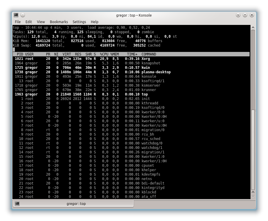

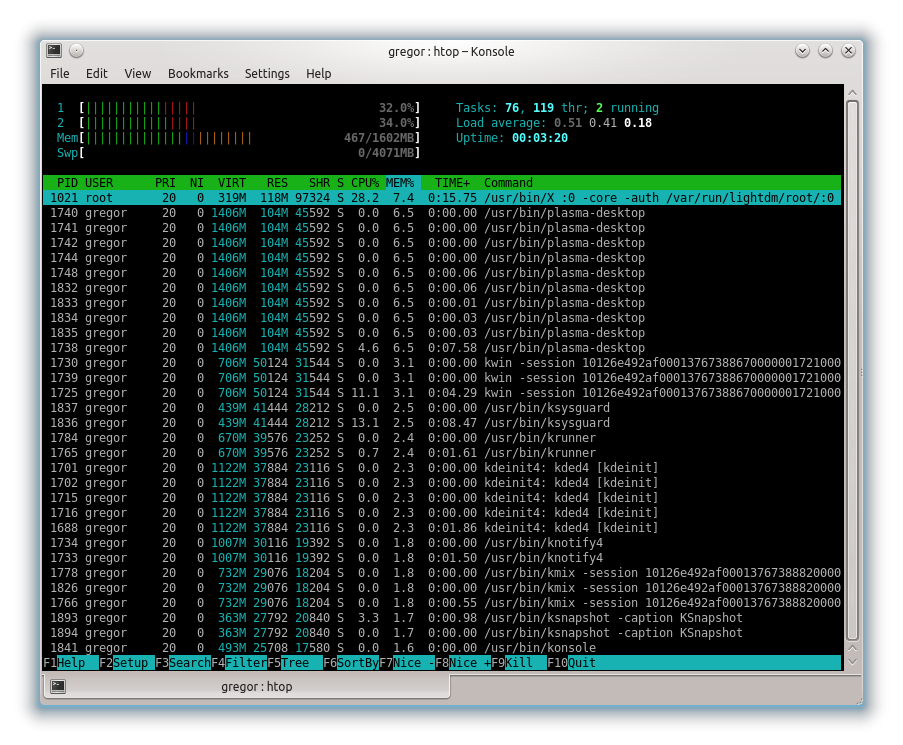

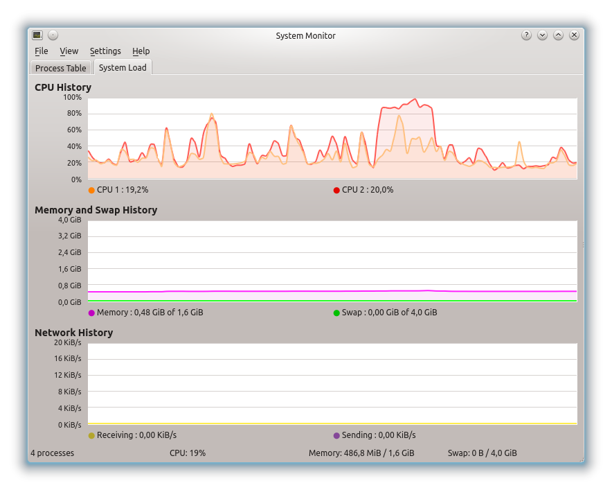

    What bothers me is that CPU is constantly doing something even if i leave it alone. both cores are occupied 12-14%. is there a reason for this? i am attaching screenshots from a couple of system monitors. would be happy if someone could explain if all is OK and as it should beClick image for larger version

    I'm not sure if it will help or not. When you install most OSes, they detect the amount of physical memory, etc, and attempt to utilize what hardware resources are available to make the OS feel 'snappy', so a lot of 'caching' is normal.
    Edit: Re: GPU and memory, yep, if it's on-board, the system 'reserves' a set amount of system memory for graphics processing, in most cases, you can raise or lower the amount set aside for this in the BIOS. Your lappy is most likely set to 384MB video cache.
    Edit 2: System Monitor is showing the OS just booted and sitting idle is using 480MB, which actually is a little bit high but nothing to be alarmed about, you also have to figure in Linux 'sees' memory as 1,024KB per MB, that extra 24KB add up in the way RAM is interpreted (a lot of hardware vendors state capacity/size 1000bytes = 1kilobyte, 1000kilobytes = 1megabyte and so on instead of the actual 1024, this is especially true with HDDs, a 1TB HDD should be 1,099,511,627,776bytes as opposed to 1,000,000,000,000). It may be caching more because it is a laptop, instead of accessing the HDD a lot.

        Another thing, you might see x% of CPU use but because most modern CPU's scale their speed it is at say 800MHz not as bad as the same x% at 2,700MHz.
        True, and I also found that AMDs like to 'race' a lot, even when they are not doing much.
          hmm so best way to see it is to use it and then measure thebatery usage on normal use to see if it's comparable to windows. as here battery is shown in percanage ratherthan esitamed time remaining. ok then. i will see how it goes when i use it more. dind't have the time so far.
