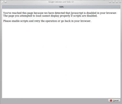

    Hi folks,
    just trying to set up google contacts in kontact and have got as far as authorizing the cridentials for the account, but I end up with
    "You've reached this page because we have detected that Javascript is disabled in your browser. The page you attempted to load cannot display properly if scripts are disabled.
    Please enable scripts and go back in you browser."
    K? What do I do from here?
    Ta
    Peter.

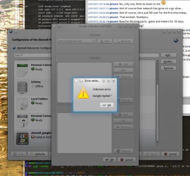

                  I thought this was solved, but I just discovered that the contacts only seemed to have synchronized once and were basically just storing locally. When I tried to re-configure the existing one, it was greyed out and eventually threw an error (attached).
                  I tried to re-add the resource (of course I suspect I've now lost all of my appointments) but can't get the stupid thing to go past this no java script issue. I have enabled them in rekonq but still no joy.
                  The page I'm getting is also attached.
                  Help please, this is the one thing that will make this system complete. I need to be able to sync with my mobile devices.
