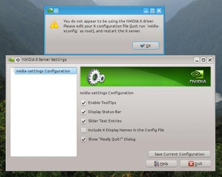

            I tried running nvidia-settings and I got the output shown in the attached graphic and then quit. I decided to try re-running the nvidia-settings as root and this resulted in the Laptop screen only having 640x480 resolution.
            After deleting the xorg.conf my system was back to behaving better and the lspci now gives

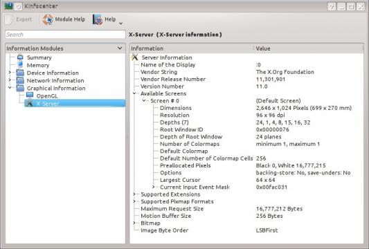

            I checked the output of Kinfocenter and now the OpenGL give the message "Could not initialize OpenGL". The X-Server now gives the output in the attached graphic.
            Thanks for your help.

                Also, does your computer's firmware (BIOS or UEFI) allow you to switch graphics to "discrete only" mode or something similarly worded?
                Sorry to say that after searching thourgh all the menus, the BIOS has no graphic options. Currently my system cannot support 3D (eg Google Earth) and OpenGL screen savers which indicates that the nvidia card is not setup correctly.
                  What's stumping me a bit is that X is skipping both the proprietary nVidia driver and the open-source Nouveau driver. On my ThinkPad, if I leave Optimus enabled but don't use Bumblebee, then X will load the Intel driver and the open-source Nouveau driver. If I disable Optimus and choose "discrete," then I can run either the nVidia blob or Nouveau. And to make you hate me even more, I can say that it "just works" without even running nvidia-settings. I can boot the laptop by itself, or in my dock at home that's connected to one digital monitor via DVI, or in my other dock at work that's connected to two digital monitors via HDMI, and always obtain the results you'd expect. I have no xorg.conf; auto-detection works flawlessly.
                  I wonder if through some blacklist-fu you can make X ignore the Intel driver and thus load the nVidia driver. Not sure. What's the output of
                  sudo updatedb && locate nvidia_drv
                    . . . And to make you hate me even more, I can say that it "just works" without even running nvidia-settings.
                    I can re-assure you that there is not an ounce of hate in me towards you or anyone else on this very friendly forum. In fact I have a VERY HIGH REGARD for your capability, knowledge and support for Kubuntu.
                    When I run the command you suggest, I get
                    :~$ sudo updatedb && locate nvidia_drv
                    /etc/alternatives/x86_64-linux-gnu_nvidia_drv
                    /usr/lib/nvidia-current/xorg/nvidia_drv.so
                    /usr/lib/xorg/modules/drivers/nvidia_drv.so
                    I decided to install Bumblebee by following the procedures from here and when I repeat the above command I get
                    /home/aurora/nvidia_drv.txt
                    /home/aurora/.kde/share/apps/RecentDocuments/nvidia_drv.txt.desktop
                    I had no difficulty installing Bumblebee and to the best of my knowledge it is working great as all applications that require 3D now work. The output I get from a test using optirun gives:
                    :~$ optirun glxspheres
                    Polygons in scene: 62464
                    Visual ID of window: 0x20
                    Context is Direct
                    OpenGL Renderer: GeForce GT 630M/PCIe/SSE2
                    125.068435 frames/sec - 108.869571 Mpixels/sec
                    132.895773 frames/sec - 115.683112 Mpixels/sec
                    131.910336 frames/sec - 114.825310 Mpixels/sec
                    133.339188 frames/sec - 116.069096 Mpixels/sec
                    130.977969 frames/sec - 114.013702 Mpixels/sec
                    132.194421 frames/sec - 115.072600 Mpixels/sec
                    133.227862 frames/sec - 115.972189 Mpixels/sec
                    132.356309 frames/sec - 115.213520 Mpixels/sec
                    133.372297 frames/sec - 116.097918 Mpixels/sec
                    133.241082 frames/sec - 115.983697 Mpixels/sec
                    134.183345 frames/sec - 116.803918 Mpixels/sec
                    137.074329 frames/sec - 119.320462 Mpixels/sec
                    133.483912 frames/sec - 116.195076 Mpixels/sec
                    So it looks like that for systems with dual graphic cards and no option in the BIOS to select a particular card, Bumblebee is the current solution. The only caveat is that optirun is required to use the nvidia card. I will be very interested to see what happens when I install Kubuntu 13.04 on this Laptop. I will not do this until LibreOffice 4.0 has multimedia support.
                    Thanks for your help and advice and I can now say that all is well.
