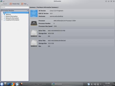

                        Prob wrong section, and real noob question, running beta 1 with 3.5.0-14. How can i get it to update to the latest one 3.5.0-15.23
                          #27
                          sudo apt-get update && sudo apt-get dist-upgrade
                            #28
                            Still ahowing up as Linux 3.5.0-14-generic
