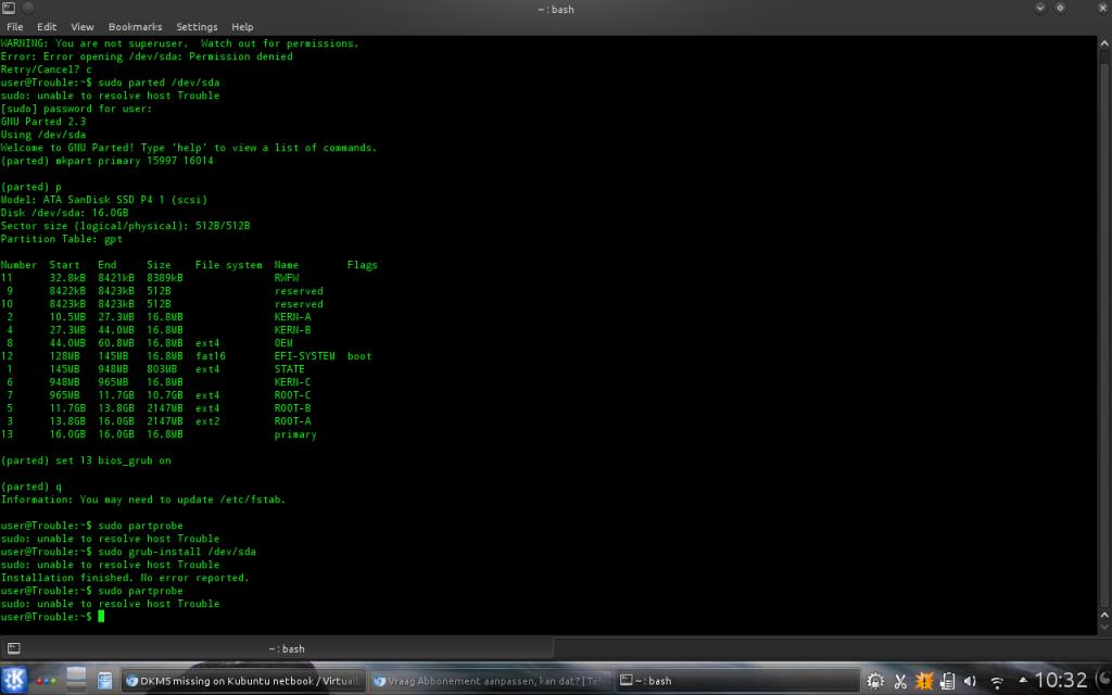

    Ok, run parted again and then these commands (after coffee,of course )
    mkpart primary 15997 16014
    p
    Then note what the number is of the new partition (I suspect 13). Enter this command using the correct number:
    set 13 bios_grub on
    q
    The last q there will cause parted to quit. Then do:
    sudo partprobe
    sudo grub-install /dev/sda
    We might run into a problem if the remaining free space is too small. Let me know what happens.
    Goood Morning!
    Okay, so set 13 bios_grub on
    q gives "Information: you may need to update etc/fstab."
