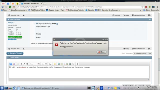

                  OK but if I run unetbootin as a user I get the screen asking me for the password (three times) and then an error message same as if I was launching the application from the menu.
                  Michel
