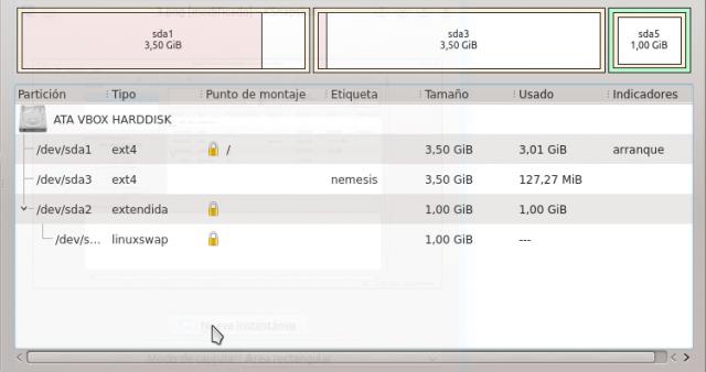

Disk partition after installation.
    I installed kubuntu with automatic partition was because I wanted to know how to partition the disk, now I'm trying to create a partition that can save my files. I tested this on a virtual machine to not affect the host system with GParted live CD, where I partition the disk, but I can not write to this partition, I would try the suggestions for implementation in the host system.

      Well the disk partition is:
      and if it mounted and I can login to it and see the lost + found folder
      but right click to create folders will not let me.

            I could solve my partition allocated to the user and workgroup:
            sudo chown-R your username: your group / point / of / mount
