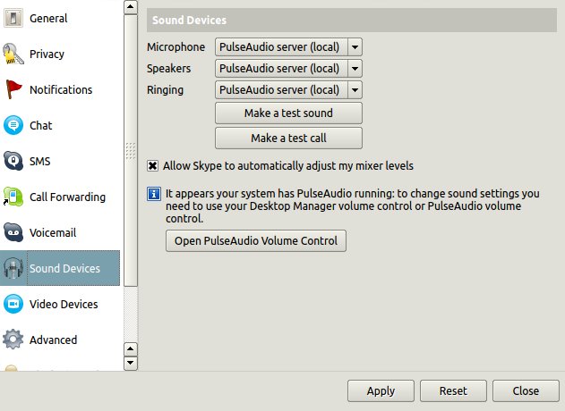

    On my installation of Skype, I have PulseAudio for my sound devices. This is shown in the image below. With this you can "Open Pulseaudio Volume Control". I assume that you have pulse audio installed. I am wondering if you have all the 32B libraries that Skype requires. Do you have ia32-libs installed?

      I have PulseAudio and library installed and the preferences in Skype are the same. I don't know what is the difference between Internal Audio Analog Stereo and Manhattan HDMI Audio[Sound Card name...]. Which one should be at the top? Also, what is the difference between /dev/video0 and Villem? I tried both and cam works ok with them. It is also worth mentioning that whenever this happens, skype stops working and I cant send any text messages also, and it's interesting that when someone sends me file, if sending lasts too long it stops working the same way!
