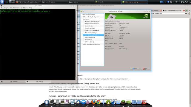

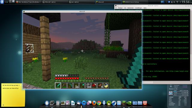

              Installed Bumblebee, success!
              Tanks!
