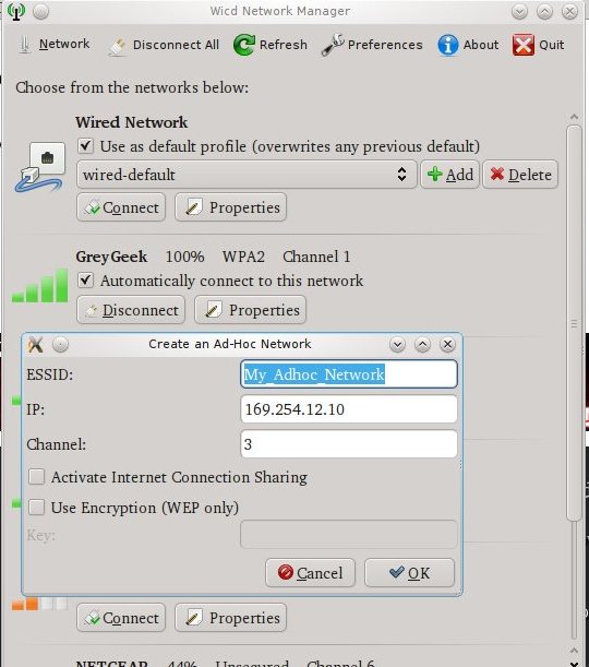

      However, if you qualify, you can use see in the attached graphic how to do it with wicd. Start with a wireless connection, but make sure the "auto wired connection" is not checked. Plug in the second computer to the Eth0 port. Then click the "Network" menu item on the wicd dialog and choose "create ad-hoc network". Make sure to check the "activate the connection" checkbox. That installs the Masquerading which allows two or more computers to use the same connection.

          You know what? It didn't work...
          Maybe I'm doing something wrong. I've tried with wicd and with network manager itself.
          My best result was the following: I was able to create a network, but it had the same range that the one I was already connect, so it couldn't be used by the desktop. Still, I tested it with another laptop and it could actually connected to it, but this second laptop had no internet connection.
          Could you please be more detailed about how to config the network ? Thanks for your time and help.
          PD: I don't know about if my wi-fi device "qualifies" or not. However, I was able to share a wireless connection via wi-fi with connectify-me app when I was still using Windows with this same machine.
