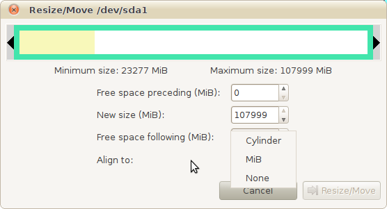

    What do you use for Align to:

          Aligned to MiB (default), as I've always used.
