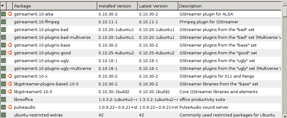

      I have reported my problem on the LO Forum but there have been no replies as yet. I thought that LO would have fixed this problem, so I tried installing numerous packages to try to get it to work. I now have sound and video working on Impress with my 64B Laptop . I did not keep a record of what I had installed so I cannot say which one made the difference.
      I therefore consider the problem to be one of not having sufficient dependent packages with the installation of Libreoffice. I have a desktop with LO 3.3.2 installed and when I ran my Impress test package on it, it was very slow and the multimedia did not work. The stop button was depressed and clicking on the start button did not change the stop state. To find out what packages are missing I have been searching for differences between the packages of the two systems. So far I have not located the one which makes it work.
      I think that when I installed the gstreamer packages (see list below), the startup speed of Impress was considerably faster. I have spent some time trying to track down the missing packages. I just hope that someone else is able to find it. In the meantime I will keep looking as time permits.

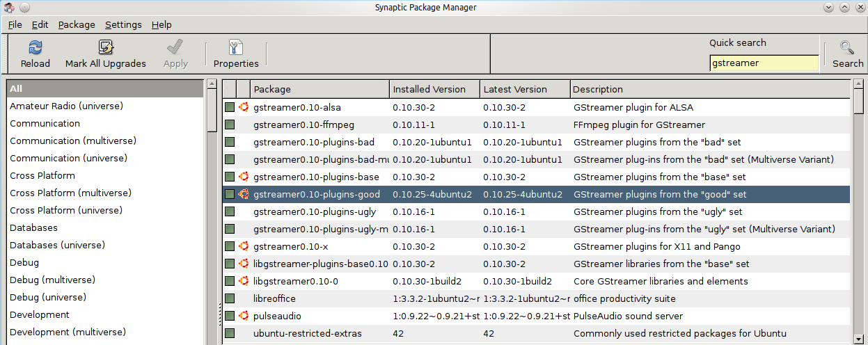

        I now have both audio and video media files inserted into Impress now working to my satisfaction . Also ppt files that were previously silent now have sound . I have found that the package gstreamer0.10-plugins-good is critical. To be on the safe-side, I have installed the gstreamer related packages listed in the attached file which shows the Synaptic listing for "gstreamer" in the search box.
        I am not sure who is responsible for packaging Libreoffice, but the relevant gstreamer packages should be included in the dependencies. I have spent countless hours trying to resolve this problem and for the sake of the Linux user community this problem should be fixed without having to resort to this level of detail.
