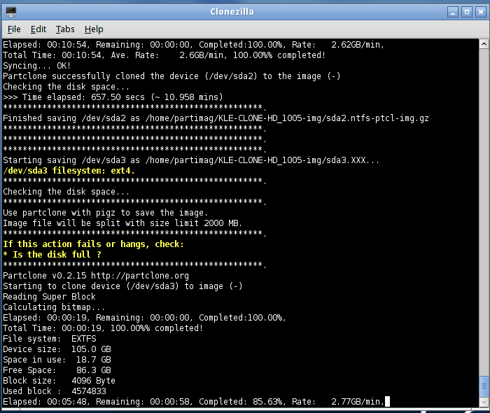

              However: no go. This time, with that fantastic toolset, I was at least able to take a screenshot. it got as far as 85% percent of the SDA3 (the partition with the virtual XP on it). Then the CPU dropped to 0 or 1% - no activity at all. I waited for a couple of minutes. The computer was not hung, but Clonezilla in its terminal was.
              As for the mounting: Clonezilla starts by asking what partition to mount and I mount my external harddisk where I now have a backup containing 18 GB time stamped a few minutes ago - There are over 400 GB left.
              Really very disappointing - but Parted magic is a real treat.

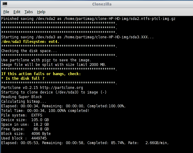

                      As it happened, my attempt got almost exactly to the same point as yesterday (approx 85% of SDA3, where the virtual machine resides). Although I had started by running check disk and defrag on the external harddisk, the cloning stopped at almost the exact same spot today as ye sterday. (By stopped, I mean clonzilla halted, the CPU usage dropped from 80% to 1% and after a few minutes I could not think of anything else to do but quit "CZ" :-)
                      I am also attaching the screen capture from yesterday' attempt and the equivalent file for today's attempt.
