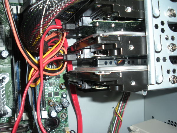

              As far as I understand both disks are SATA: a red flat cable with a black plastic connector, very flat and about 1 cm wide (and a similar but a bit wider power supply cable). About that SATA mode and AHCI, I am afraid I need some more information about what you mean (I am not such a specialist...). Does the included picture tell you more ? Do not look at the lower of the three disks, because it is not connected. The upper one is lucid, the middle one is edgy.
