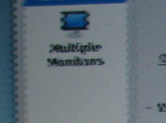

              I have the same problem, and when I have the second monitor plugged in I get both set to 1024x768. If I then set the monitors to the auto setting values defined by System Settings > Display define the position as "right of", the display that I get on the second monitor shimmers. To capture this "feature" I had to use my camera. I am not sure haw to attach an image to a reply but here is my attempt to demonstrate the problem that I have. The video card that I have in my Laptop is an ATI Radeon X2300.
              The "solution" that I have is to not have the second monitor connected when Kubuntu is booted. When it is up, I then plug-in the second monitor, or in some cases a digital TV screen, and then select System Settings > Display to set the monitor using the "auto" values and the position to "right of". After applying these settings, every thing works well. Unfortunately, this has to be repeated every time I reboot the computer .
