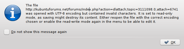

          This is the exact message that Kate issues when opening the index.php file:

              Also, file properties should show it as a php file even with a .txt extension because of the <?php at the top of the file.
              If I go to Tools and untick Read Only I can then edit the file.

                    Notabug. At least I don't think so.
                    I got to looking at the file I uploaded - if you look at the bottom of the file you'll see it's machine-generated on the fly as the file contains the date and time it was downloaded toward the bottom of the file. I tried a couple more vbulletin php files with the same result so I went and downloaded a couple of php scripts from other sources and they opened RW just fine.
