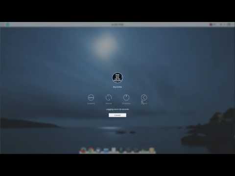

              However, with Kubuntu running the plasma-desktop (created using the Qt API), using the Konsole isn't a necessity. But for those Linux gray hairs it is often the fastest way to do something, if one knows how. For young Penquins there are videos explaining how to configure the plasma desktop:
