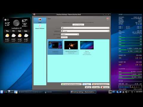

    you can put the image in any place/folder you like then ,,,,right click the desktop/screen>click default desktop settings>down at the bottom under the rest of the wallpapers you can chose from click the "open"button and navigate to where you keep the image you like ,,,,,,click it .
    it will appear in the wallpaper selection window and it's location will be remembered
    hear is a screen cast of the process
      By the way, the screencast is really cool.I am embarrassed again, my friend. I have done that so many times, it doesn't seem possible that I could forget. I actually thought I had attempted the exact same process and failed each time. It worked perfectly, of course. I am so sorry to keep screwing up on the easy stuff. Thanks again for your patience.
