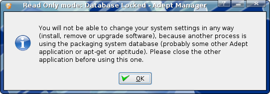

            Please, please, please help me. I'm having this exact same problem. I'm looking in ksysguard-process table but I don't know what I should be killing and the kill button doesn't seem to be working anyway. The problem just isn't going away. I've tried rebooting. I've tried switching off then booting. I've even tried $ sudo kill KILL -1 which apparently kills everything, and I ended up at a command line but nothing has worked so far and I don't want to have to reinstal the whole system because of this.
            I've even attached a screenshot of the error message.
              Re: i can't install anything-errors with adept and ....
              Sorry UnicornRider your link kept timing out on me. I just read the article and this:
              $ sudo --configure --pending
              fixed the problem. Thank you, you're a star and thanks to the unqualified penguin trainers (I love that).
