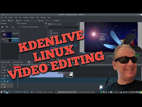

Now that I had made a recording of one session of Minecraft I decided to use Kdenlive to edit it. That's where Marcel Gagne came it. He had a 40 minute drinking party which included a simple example of how to use Kdenlive.
It also showed him using qemu-kvm to demo Arcolinux. A two-fer!
