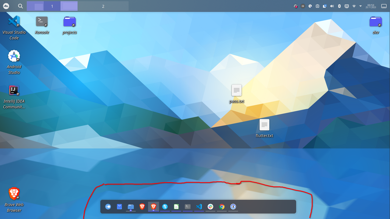

    I've recently started using Kubuntu as a main system for coding, it is so far working marvelously, I've achieved UI & functionality customization I was dreaming for. One last thing bothers me though, I don't know how to make my floating Icons Only Task Manager to show up when I navigate with mouse to the bottom edge of the screen (while covered by applications). I would want to achieve a similar effect to MacOS applications menu at the bottom of the screen, to be precise I want the task manager to show up above all the applications windows when I go with my mouse from e.g. center of the screen to the bottom. I didn't find any solution for that in the settings :/ Only hope with you guys, does anybody know how to achieve such effect?
    Cheers
    Screenshot: https://i.postimg.cc/pLx1dzM2/T.png

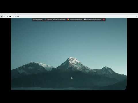

    The panel has to be set to autohide, not the task manager widget, which is just one component, or widget on it.
    Your screenshot link is broken, it hass extra characters in it: https://ibb.co/qg13z1D, the text is correct, but the actual URL has extra characters at the end.
    Autohide might be broken or something?
    However, if you simply added an Icons-only widget directly to the desktop, and NOT part of a panel you won't get autohide. It needs to be on a panel, as the panel is the part that has the option.
    (you can remove all the other widgets items except for the task manager, the video here has the application menu on it as well)
    Like so:
    And the settings I used to quickly make this:
    Click image for larger version  Name:	Screenshot_20231124_201938-1.png Views:	4 Size:	523.2 KB ID:	675466
    And reading again, it seems I missed the gesture request. THAT, I dunno if it is possible , am looking. But moving the mouse from anywhere to the bottom area should raise it.

      I think the issue was, as you explained, that I added the task manager independently without a panel as a parent. I fixed it now by adding a panel and setting it up as on the screenshot provided by you. Now everything works perfectly
