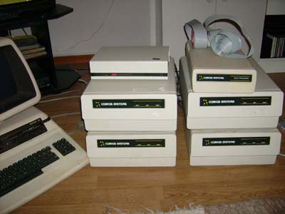

                Back in the early 80's a client running an Apple ][ with two DISK ][ drives ran out of drive space. I had written an Point Of Sale app for his parts and fasteners store.
                I attached a Corvus 5MB HD to his Apple. One had to let it "warm up" for 5 minutes before turning on the Apple.
                http://www.cbm.sfks.se/pics/corvus-2.jpg
                Backing up the Corvus was accomplished by using a VCR. It took about 20 minutes to back up the Corvus. The client backed up twice, first over the lunch break and secondly after work.
                We both though "Wow, that's a barn! We won't need additional space for years!" We were wrong. In less than a year he filled up the Corvus 5MB and replaced the Apple+Corvus with an IBM XT with a 10MB HD, for about the same price as the Corvus. I had taught his son how to program (he later earned a PhD in computer programming) and he kept modifying the software as his dad came up with new ideas. I stopped tracking their expansion when they moved to the first 1GB Barracuda drives.
