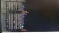

            Got a couple of screenshots, well photos, in case that's of help: https://1drv.ms/f/s!Avv04SyB_Fr_jelaDjdX5sn9ZQz0SQ
              Saw your photos.
              You were shutting down and the target had almost been reached when encryption failed ag 117 seconds. That locked the system into read only and none of the subsequent attempts to save journals succeeded.
              Time to roll back to your most recent @ and @home snapshot. Then take a look at your encryption protocols.

                The encryption one is just one example, actually I wasnt shutting down but all of a sudden my apps crashed one after another which made me switch to tty2. And when I saw the errors floating by I knew there’s no way to rescue the situation so hit the power button which led to the shutdown and encryption message.
                The other crashes today were e.g a sudden freeze of the ui, and switching to tty2 just gave me a blinking cursor.
                It’s never like a power outage though, power is always there and with all crashes the cpus seem to go into 100% mode as the laptop will heat up and the fans will start blowing.
                Something seems to happen which makes the file system switch to ro, or disapear completely with the effect that there are no logs showing anything. I checked dmesg in previous crashes and found only standard stuff...and then the boot sequence.
                I wonder if I am dealing with an issue related to running btrfs and encryption together. Maybe I have to simplify things step by step...

                              ReadOnly mount and strange ls -al after a crash:
