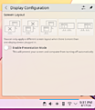

how replace dual monitor setup after KDE 6: monitors are mirrored with two cursors and no panel on dtdhe desktop
    Where is the spot to intervene or replace items to get my two monitors working together again with separate info in a usable desktop with a panel?
    I used to be able able to tweak Display and Monitor within System Settings and work with the monitors until recently.

    As Plasma 6 itself is still buggy enough I would "nuke and pave" if I had upgraded from Plasma 5 = don't additionally use settings or cache files from 5 in 6 would be the most reasonable option IMHO.
      System Settings > Display and Monitor >
      Both monitors should be listed in the "Device:" pull-down.
      Verify both are "Enabled"
      Select monitor 2 in the Device pull-down, then grab it with the mouse in the window where it says "Drag screens to re-arrange them" and slide it around until you get what you want. Click on "Apply" in the lower right corner of the window.

        Are you able to right-click on the desktop(s) and add a panel?
        have you looked at the display settings from the System Tray? (once you add a panel)
        I wonder if it is set to be mirrored, maybe?

        You could add the Display Settings widget to your desktop temporarily

        Is this a laptop? these often have Fn keys that also can switch this, at the hardware level.

        But, you might be better off starting by trying a new user account and see how that behaves
        (open System Settings or other applications from Krunner /alt-spacebar)

          To my surprise everything for dual monitors on my system almost appears to be working now and then after trial and error following oshunluvr​'s and claydoh's suggestions. (I could move a single cursor between two monitors instead of mirrored monitors and two cursors.)
          But my setup is fragile, and I lost it again for awhile, (No panel, cursor trapped on one monitor or a monitor shut off.)
          (I had played with Display Settings early in the day and lost my panel, got mirrored monitor displays and two cursors again. Now I am trying not to lose separate displays and a single cursor that moves between displays.)
          I managed to get my setup working for the most part now. (two monitors are working but I have to do a dogleg with the cursor between them)
