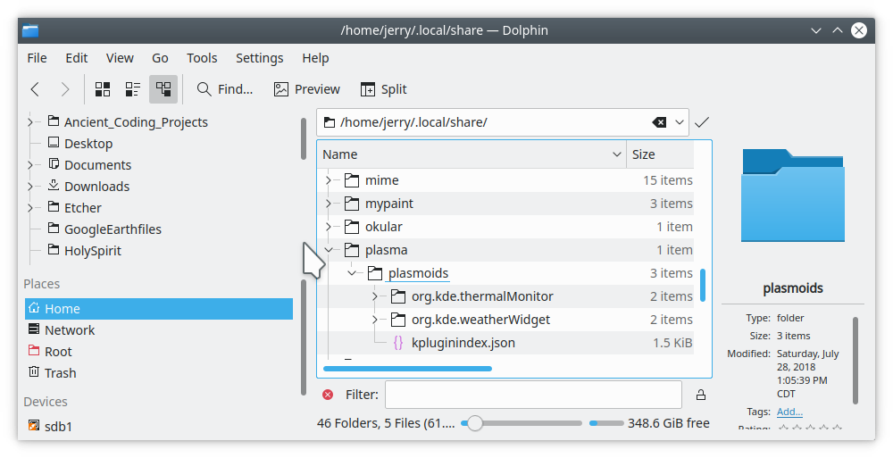

        I have. Here is what is in my plasmoids subdirectory.
        If you haven't added any plasmoids then they can't be your problem, unless one of the system icons in the panel or system tray has gone bad. That means that perhaps your theme is broken...
