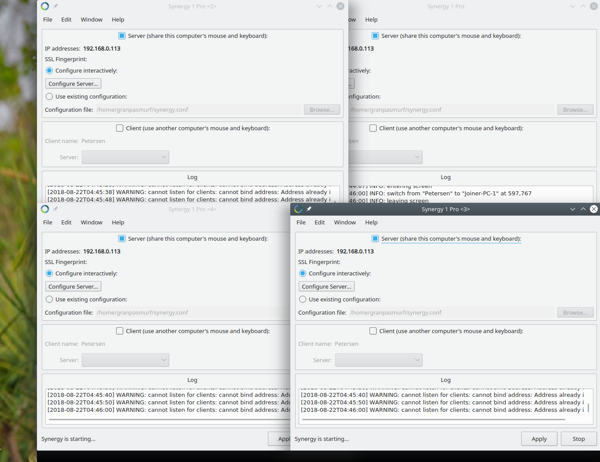

    I have a utility program installed that pops up 4 instances whenever Kubuntu starts. How can i edit/config desktop manager?

      Synergy version 1
Name:	Synergy X 4.png

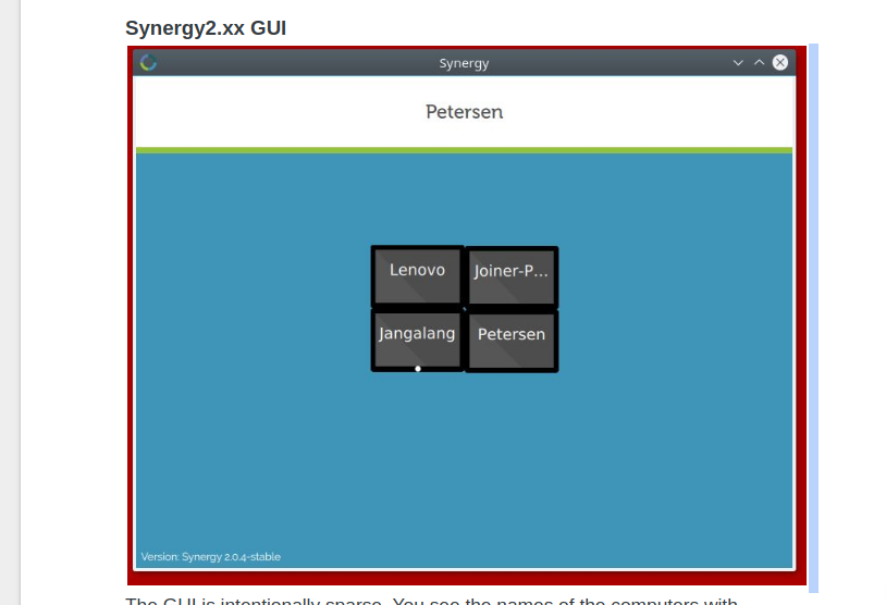

            Synergy allows one to link several computers together, using one keyboard and mouse. The image below is from a different version, but you can see the configuration of my systems. The mouse moves seamlessly from one screen to another (one computer to another). The installation I am working with right now is an RC version. Looking at this image, I am right now using 'Petersen,' computer, it is the 'server.'
Name:	Synergy 2 GUI.png

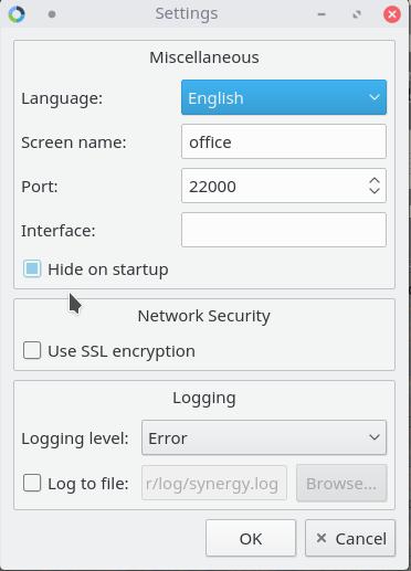

                    Synergy has it's own setting to not show on start up also:
