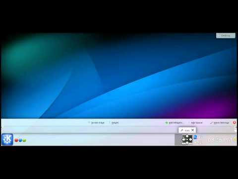

            It should be similar to how it is in Plasma 5, but will look different. Right click somewhere on the panel should being up a "configure panel" or "panel options", which will make the panel look like the video below. Also, to the extreme right I think there should be an icon of some sort that will bring up the panel configuration. Again, see below. As you hover over different widgets on the panel, a tab should pop up, where you can click the X to remove it. You may have to right click on your desktop somewhere and un-check "lock widgets"
            Also note that each component on a panel is a separate widget - Kicker (Kmenu), the taskbar, the Systray are all movable, and if memory serves, easily removed by accident if you are a klutz like me.
