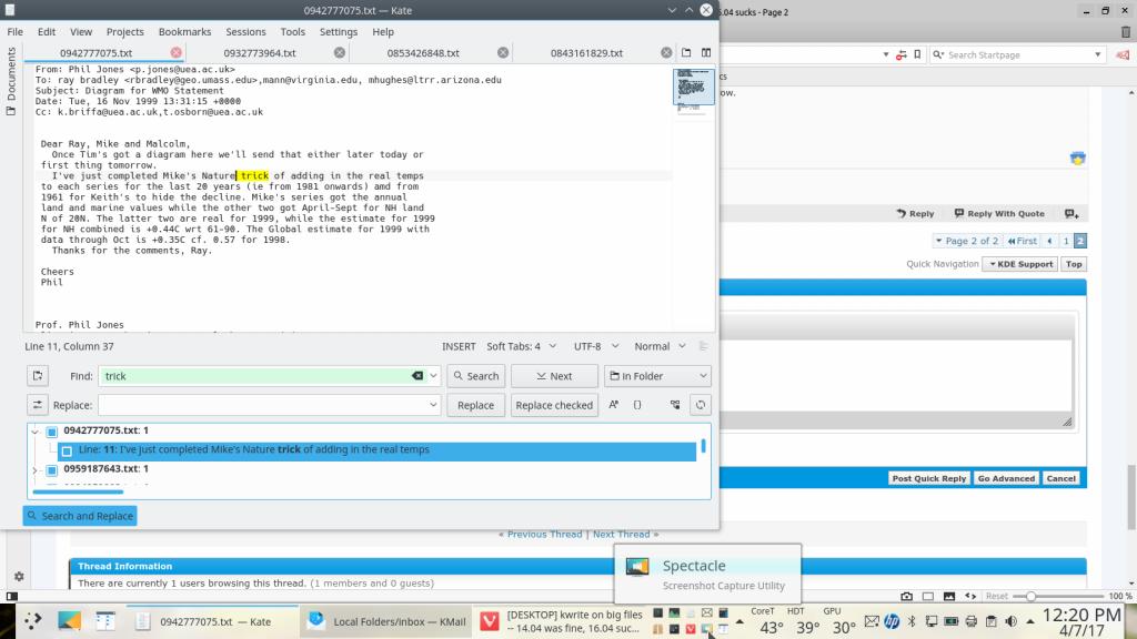

              Open a folder with thousands of text files in it and do a search for a word or term and Kate finishes *VERY* quickly. In one with 1,700+ files it took a fraction of a second. In one with 5,000 files about 2-3 seconds. Here's an example of " hide " (as in the decline):
              I've had as many as several hundred selections in the bottom panel and as I clicked on each one the file opened in the top panel and display the search word, highlighted in yellow.
