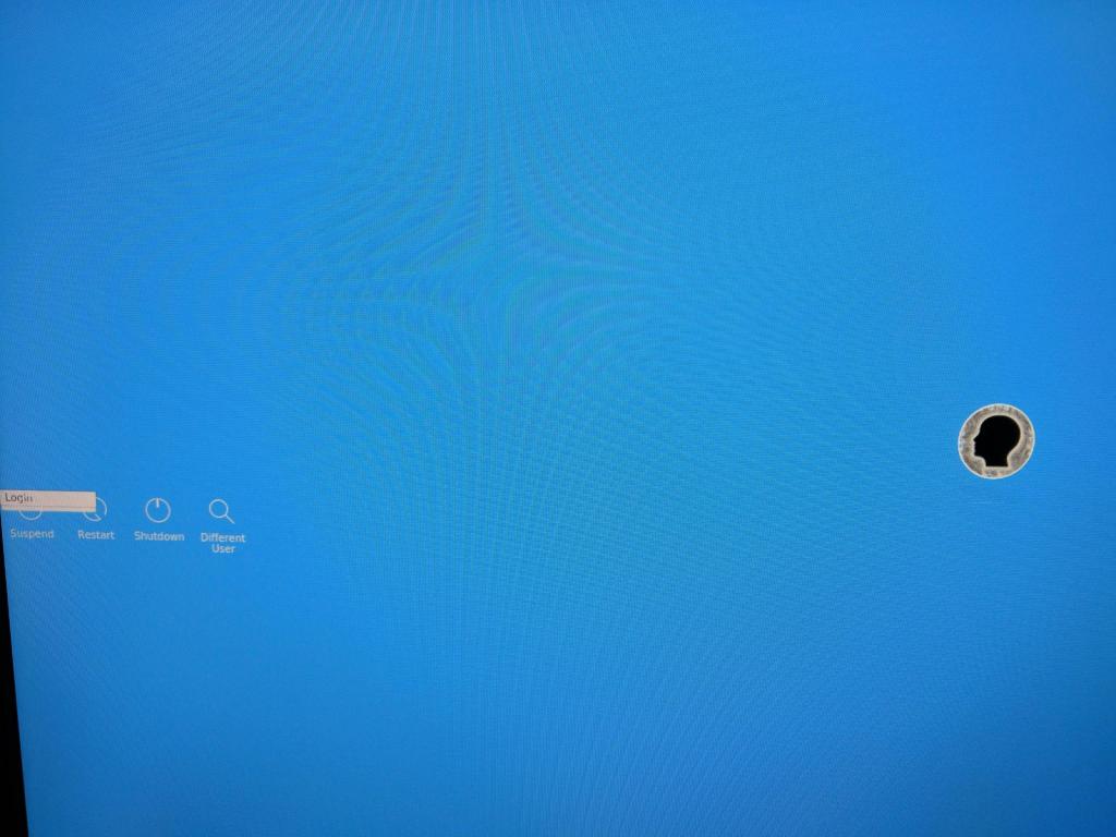

    Well, the login screen is completely messed up also. That would point to there being a non-user-specific system issue ya?
      Yup. That pretty much indicates X is kinda broken but we did fix all sorts of other stuff
      I would like a second opinion before we go much farther, but my gut response would be to remove the Nvidia drivers and their corresponding X configuration and use the open-source driver at least temporarily. The open-source Nvidia driver (it's called nouveau) does not require xorg configuration. Do you do any gaming on this machine? I personally prefer the open-source driver (fewer headaches, smaller memory footprint) but it's entirely up to you.
      I'd like to ask - did you configure xorg manually or using nvidia-xconfig (which IMO is kinda broken)? Your X configuration should be in /etc/X11/xorg.conf.d and there should *not* be an xorg.conf in /etc/X11.
