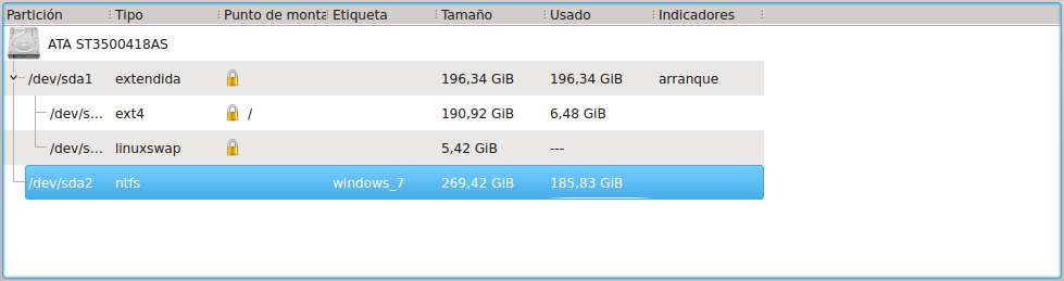

                        I have these partitions:
                        /dev/sda1    *          2,046   411,760,639   411,758,594   5 Extended
                        /dev/sda5               2,048   400,390,143   400,388,096  83 Linux
                        /dev/sda6         400,392,192   411,760,639    11,368,448  82 Linux swap / Solaris
                        /dev/sda2         411,762,688   976,766,975   565,004,288   7 NTFS / exFAT / HPFS
                        As you can see, Windows is at Sda2/
                        KDE Partition capture:
