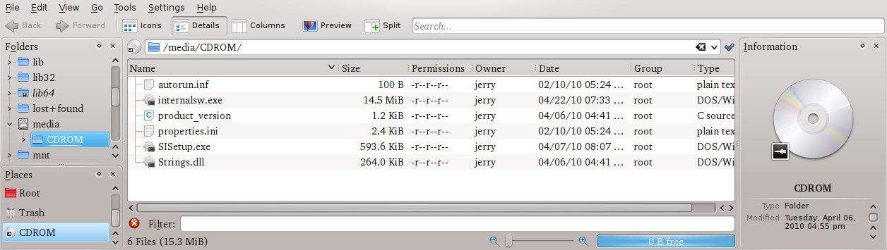

    There is another peculiarity about the printer. When I plug it in, instead of telling me it is a printer I get a notice that a CDROM device has been plugged in. It never did that before this system tray icon problem appeared, which I believe is either an xserver and/or bus problem (d? i?). Here is the CDROM info:

      Then I plugged in my HP printer. It was immediately detected as a USB device but before I could click on anything to install it a msg appeared reporting it as a CDROM device, just as my Lucid Host popped up its "you've got a CDROM plugged in" message. Then, just as quick, a dialog box appeared asking if I wanted to install the "HP LaserJet series 1100, 1200, 1400, 1500 and 1600 printer". I said yes. When it was done a dialog box popped up saying the install had failed! Its suggestion was to unplug the printer, turn off the printer, turn on the printer, and plug it in again. Steps I had done many times before on Lucid. At that instant a msg box appeared on Lucid's system tray announcing that the HP printer had been detected and installed. Amazed, I opened KWrite, typed in a line and sent it to the printer, which was now on the list with no warning signs. It printed!!!
