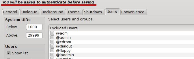

                    I don't have a maverick machine to test, but on Natty the authentication seems to be handled by policykit (you need to authenticate when you save changes, not when you start the module).
                    I guess it depends on policykit settings, but I'd find it very odd if Maverick allows editing kdm settings by a regular user by default. Could you test that by creating a new (test) user and see whether that user can change the settings?
                    Here's a screenshot from Natty

                      Ah! Okay. Yes, I see that statement on each of the Tabs. That actually makes sense, and a nicer approach as well. Allow the user to access the module; see what's there, but require authentication if any changes are made and desired to be saved.
                      Thank you kubucle.
