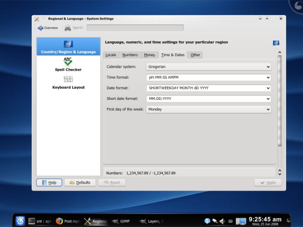

            Re: Changing 24 hour clock to twelve hour
            System Settings --> Regional & Language --> Time & Dates tab
            Change the time format to pH:MM:SS AMPM.
            Restart KDE.
            -SNT
                This works for me in KDE 4.x
                See screenshot.
