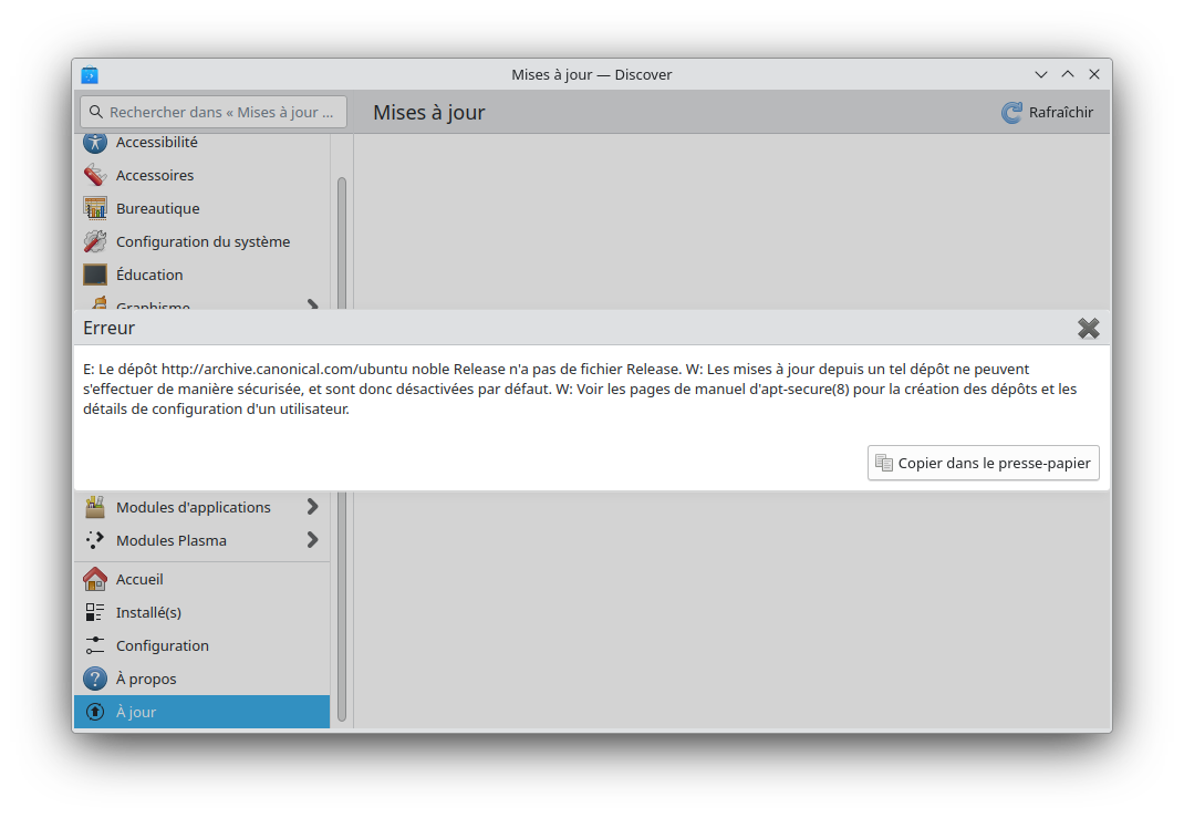

    Hey there, i’m obtain a problem in kubuntu 24.04 :
    Operating System: Kubuntu 24.04 KDE
    Plasma Version: 5.27.11
    KDE Frameworks Version: 5.115.0
    Qt Version: 5.15.13
    Kernel Version: 6.8.0-51-generic (64-bit)
    System Version: 1.0
    and obtain this error on apt update or discovery also link on file
    E: Le dépôt (adress) noble Release n’a pas de fichier Release. W: Les mises à jour depuis un tel dépôt ne peuvent s’effectuer de manière sécurisée, et sont donc désactivées par défaut. W: Voir les pages de manuel d’apt-secure(8) pour la création des dépôts et les détails de configuration d’un utilisateur.
    I know a little linux but i cant make complexe thing for solve this. Then if you know why i obtain this source error, thanks to give me a simple issue.

    Screenshot_20241226_180516
    Screenshot_20241226_1805161070×739 78.9 KB
    Ps: i already check and try to change source list
    i also have one other error can help you to know where the problem com from to install Windscribe and i can case i miss some dependencies
    Translation:
    E: The noble Release repository does not have a Release file. W: Updates from such a repository cannot be performed securely, and are therefore disabled by default. W: See the apt-secure(8) man pages for repository creation and user configuration details.​

            `archive.canonical.com` repo in your error is an old one that doesn't exist any longer, and hasn't for many years now. So you added something you need to remove.
            You need to remove or disable it, either using the Software Sources tool or by editing your /etc/apt/sources.list file.​
            To access the Software Sources tool, you will need to get there in a backward manner, via the Driver Manager due to a known bug from changes in how the software sources are formatted, which breaks showing them in Discover.

            Or undo whatever you edited when you added this in the first place.
              Good Lord Thank You so much Claydoh ! that work, i show you how it was natturally after i install Kubuntu 24.04 two weeks ago.
              Thanks again to show me the way to just uncheck those two old and i gona remove them.

                There is no way that a normal kubuntu install of 24,04 has a repo that stopped being used after 12.04 (from 2012)
                See my image which is from a bone stock fresh install.
