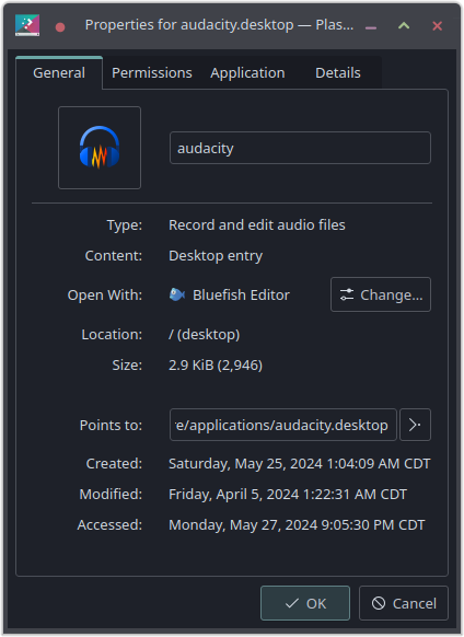

    Hi All,
    I recently ran into some strange behavior with my KDE desktop. My shortcut icons no longer work. Instead of opening the desired application, they spin for a couple of seconds and then nothing. I looked at the properties for a few of them and the Open With entry is set to my BlueFish editor (see screenshot), which doesn't make sense. The application tabs seem normal. The programs will run normally from the Launcher, just not from any shortcuts. It's a system-wide issue because it is the same for all users. I was hoping the update to 24.04 would fix it, so I ran that last night. No luck.
    Before I blow the system away and do a clean install, I thought I would give the forums a try to see if someone had any idea what happened and how to fix it. Any help is greatly appreciated.
    Originally posted by Neoneuro View Post
    ... I looked at the properties for a few of them and the Open With entry is set to my BlueFish editor (see screenshot), which doesn't make sense.
    I think that is what is expected; the "open with" applies to the .desktop file. Mine show as "Open with: GVim"; gvim is my text editor.
    If you create a new desktop icon from the menu does it work i?
    Can you share the contents of one of the .desktop files for an icon that doesn't work? It would be the file specified on the general tab of the properties; for example, I have icon called "blue", and the properties says "blue (1)", location "/home/john/.local/share/plasma_icons" and the .desktop file is '/home/john/.local/share/plasma_icons/blue (1).desktop'.
      If you create a new desktop icon from the menu does it work i?[/CONSOLE].
      Thanks for the response. No, they don't work. I will get a slight flicker of sorts that hints something might happen, but then nothing. Every desktop icon does this without exception.
      I included one in my original post, but here is another one. Another thing that I just noticed is that all of these icons have a link icon in the lower right corner. I assume it's a link because it looks like a couple of pieces of chain. That wasn't there before. Any help or advice you can provide is greatly appreciated.

          Now there is something that confuses me a lot... it's like there are two "desktops", the plasma desktop, which is really what X11 calls the root window, and the Desktop folder. The plasma desktop can be configured to show the Desktop folder, but does not have to be, and I don't, but it seems you do.
          The Desktop folder typically has links to .desktop files somewhere else. They show in italics in dolphin. I've no idea how you got the "points to" like that; it should be /usr/share/applications/audacity.desktop. You could edit the link to point to the right place.
          Generally speaking, elements of KDE (and other DEs) as distributed are in /usr/share, and if a user customizes them they are copied to ~/.local/share, so "/home/jim/.local" replaces "/usr".
            Sorry for the delay in responding. I pretty much threw my hands up with this and resigned myself to a full reinstall. In preparation for that I downloaded a fresh copy of Debian 12.5 and installed it on an old laptop choosing KDE for the desktop instead of Gnome. I did a scorched earth install. Wiped everything out.
            The VERY first thing I did once the install was complete was to create a desktop icon for a program. To do this I went to the Launcher, picked a program at random, in this case it was Kaffeine, right-clicked and chose Add to Desktop. It created the icon but had the little link symbol on it just like Kubuntu. This didn't bode well but I double-clicked it and it actually ran Kaffeine. I right-clicked on the icon and the Points to: field has an error like what I am seeing in Kubuntu. It says The file or folder /home/jim/Desktop/usr/share/applications/org.kde.kaffeine.desktop does not exist.
            This leads me to believe it is an upstream issue since I'm seeing the same thing in multiple distributions. The only difference between the icon properties seems to be in the Open With: field and that's just due to local configuration. The Debian install shows Kate whereas the Kubuntu install says Bluefish. Those are the default text editors for the respective systems. I'm not sure why the system would point to the editors to open the files, but that's what I'm seeing on both distributions.
